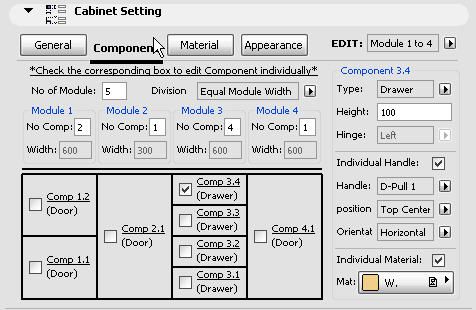

Need comment on UI
LiHigh
Do you think that the UI is too crowded?

looks fine.
How much bigger would you make it?
Dwight Atkinson
LiHigh
Thanks Dwight, I'm glad that you like it.
The UI real estate is just way too small for my liking!
Infact, I've more parameters that i wish to squeeze in rather than have another page.
BTW, this is a Cabinet object that I'm curently working on. I decided to create this cabinet OBJ because I've encounter too many bugs in Cabinet Builder! I intend to make this obj as parametric as possible but not making it too confusing to use.
My goal is to be able to individually assign the following attrbutes to each Panel/drawer:
1) Component type ( open shelve, door, drawer) & height.
1) Door style & material
2) Opening direction if it is a door
3) Handle type, orientation, & material
On the other side, it is possible to assign these attributes globally too.
Guys, please feel free to voice up what other things that need consideration from an user point of view.
Thanks in advance.
