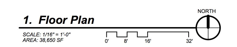

Can anyone help guide me through how to create a title type that matches the attached image? Archicad ships with one that is fairly close, but doesn't have the north arrow on it, and the graphic scale looks different.
Any gdl gurus able to whip this is up like its nothing? Im no GDL guru, and Im at a complete loss.

You should be able to draw what you want with 2D elements, insert the Text fields you want, then use the "Save as Title Type" command under your File > Libraries... menu.

I can get everything to work except the graphic scale. Thats the part that trips me up.

Without GDL... that might not be possible. You would need to tie the scale to the viewport somehow, which most objects cannot do without some scripting.

TomWaltz wrote:Right, Hence my posting here in the GDL forum.
I've done a few simple gdl tweaks before, but I'm going to need some guidance on this one.
