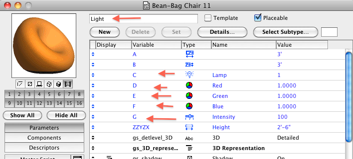

If I have a regular object I made or downloaded, how can I save it as a lamp object?
Open the object and change its subtype to "Light" (US library) as seen in the attached screenshot.
Then...
Karl Ottenstein
Moderator Emeritus
That makes a couple of things happen. One, the being now of the Lamp subtype, the object will be placed with the Lamp tool and not the generic Object tool. Two, additional lighting related parameters are added as seen in the attached screenshot - to turn the lamp on/off, change its color and intensity.
Note that these new parameters will not do anything though unless you modify the GDL code to include a lamp to emit light, tied to those parameters.
In the screenshot, I've turned a bean-bag chair into a lamp object, but it is still just a bean-bag chair.
Easiest thing for the GDL code is to just copy a snippet from an existing lamp object in the library. Getting the lamp aimed in the right direction could be the most challenging part.
Cheers,
Karl
