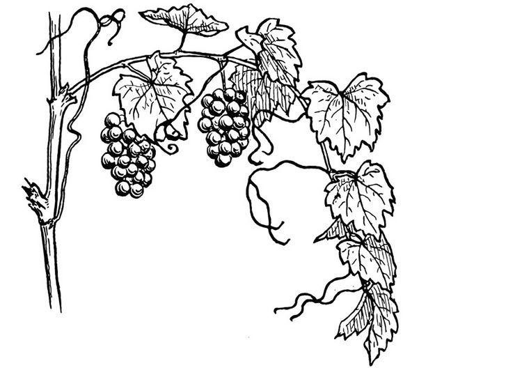

Does anyone have model of grape vine, or sth like that.I need it quick...Thanks!

Thank you but I was looking for grape vine - a plant (tree), not just fruit....Like in the picture...
