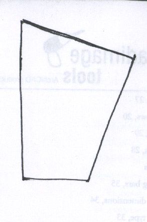

I'm attempting to create a window that in elevation, looks like this image. (see attached)
I can get a sloped header using D&WB but getting a canted vertical on one side is proving to be more difficult.
I know I can create one out of walls and slabs, but I'm trying to avoid that for obvious reasons.
Does anyone know of a gdl for this type of window?
Or am I just missing some object/setting that is already included.
I'm using AC10 w/ door and windowbuilder 3.5

Check out the "Fee form window" object in the Object Depository.

Thanks Peter, I'd forgotten all about the depository, good find.
It works fairly well.
I still need to be able to break that window up with some mullions/operations.
But I should be able to use this in conjunction w/ slabs as a workaround for now.
thanks

Try using different shape options in DWB, as in the attached image...
