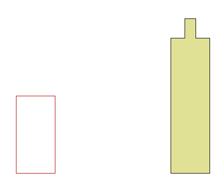

I have two objects that use POLY2_B which allow the user to choose the colour of the background fill.
What is weird is that one object works as expected whereas the other doesn't. I can't see any difference between the 2d scripts. The only thing that is different is the one that works was made with AC 7.03 in Mac OS9 and the one that doesn't work was made in OSX
Anyone else come across this problem?
Here is the script that works
PEN fpen
FILL fhat
POLY2_B 9,fhat+2+4+9,penbf,penbf,
0.0, 0.0, 2+4+9, !1
0.00, fdep-thglaz, 2+4+9, !2
(fwid/2)-0.007, fdep-thglaz, 2+4+9, !3
(fwid/2)-0.007, fdep, 2+4+9, !4
(fwid/2)+0.007, fdep, 2+4+9, !5
(fwid/2)+0.007, fdep-thglaz, 2+4+9, !6
fwid, fdep-thglaz, 2+4+9, !7
fwid, 0.0, 2+4+9, !8
0.0, 0.0, -1
And this is the script that doesn't work
PEN fpen
FILL fhat
POLY2_B 5,fhat+2+4+9, penbf, penbf,
0.0, 0.0, 2+4+9, !1
0.0, b, 2+4+9, !2
a, b, 2+4+9, !3
0, b, 2+4+9,
0, 0.0, -1

Have you tried putting both scripts into the same object 2D script (both the working and non-working object script) to see if they both act the same within each object?

I pasted the working poly2 script into the object with the problem and the it still works but the poly2 that doesn't work still doesn't work
I've attached an image of the result. The object on the left should be displaying the same colours as the object on the right.
What I have also noticed is that the poly2 on the left is using the colour of pen that would be used if the user unchecks the "Use symbol colours" button

Ahhh ha! spotted a RECT2 that was picking up the default pen and drawing over the top of my POLY2
What I'm getting now is two of the POLY2 contours showing but the other two are not showing along with the background colour which is missing.
PEN fpen
FILL fhat
0.0, 0.0, 2+4+9, !1
0.0, b, 2+4+9, !2
a, b, 2+4+9, !3
0, b, 2+4+9,
0, 0.0, -1
line "2" and "4" are the same. Try changing the "fourth" line to "a, 0, 2+4+9,"

fuzzytnth3
Brilliant stuff! A fresh pair of eyes did the trick I've been looking at this on and off for the last two weeks dooh
