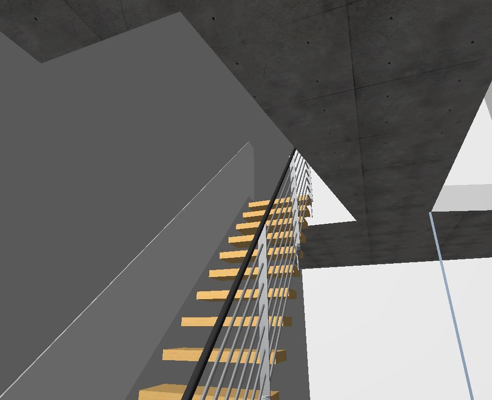

My design is meant to have a diagonal stair going from the ground floor to the 1st floor.
However, all I can create with Stairmakers seems to be straight!!
What should I do..?
By using slabs to make 1 in GDL, I have no idea what to do with it afterwards...

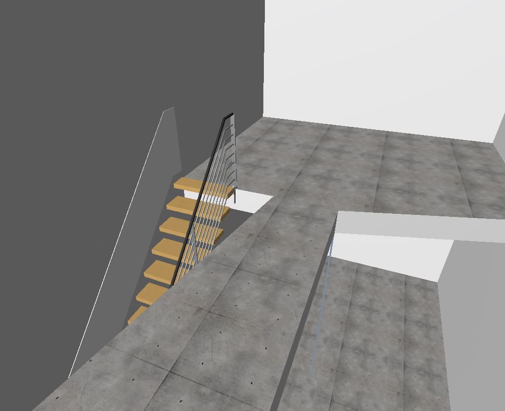

here's another picture from 1st floor looking down

Create Stairs using selection?

I've not really done this, but I know where it is in the documentation:
Archicad 10 Help: Virtual Building: Standard Elements: Stairs: Custom Stairs.
you can create a stair by drawing a fill and a couple of lines and than use 'design/create stair from selection' to make almost any stair you can think of....
see http://archicad-talk.graphisoft.com/viewtopic.php?t=13967 for example.....
Frank Beister
Or have a look to the skewer-object of Karl. Available at openGDL.org
