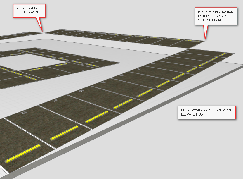

-3D elevation and inclination per segment (length and depth): it can easily do parking spaces in ramps and platforms in different levels; work first in plan, then elevate in 3D.

sinceV6
in 3D
