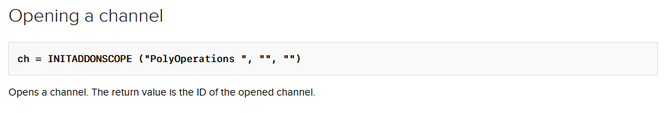

Just want to note this as an error in the documentation for PolyOperations:
ch = INITADDONSCOPE ("PolyOperations ", "", "")
The innocuous space after "PolyOperations" prevents the channel from opening. I spent quite some time trying to understand why my project wasn't working. Just be wary if you're copying commands directly from the GDL reference!

@s_p_b wrote:
I am using the online documentation:
https://gdl.graphisoft.com/reference-guide/polygon-operations-extension

Sure, done.
