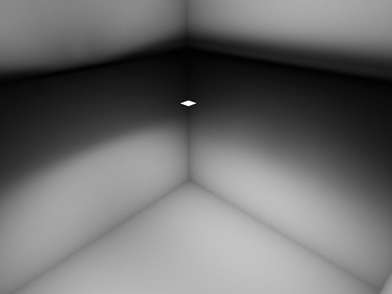

I'm having an issue using the IES light object in Archicad 19 - apologies if I have put this in the wrong forum.
As far as I understand, the IES object is able to pick up the luminous size of a IES file (if included within the file itself) and is able to generate an illuminated shape to represent these dimensions. This is of particular importance when using IES files to represent fluorescent fittings/strip lighting, as the IES profile must be "stretched" accordingly.
I am currently using an IES file from Fagerhult (http://www.fagerhult.com/Products/DTI/DTI-type-2-Beta/), which I have checked and does contain dimensions for the luminous opening, however when I activate the options in the light object to use the size as given in the source file, it will only render out a small square at 100mm x 100mm - see the attached image. The luminous opening in the IES file is 1.44m x 0.08m x 0.00m. I'm using the Maxon CineRender.
This doesn't cause a problem for point/circular lights, but for rectangular fittings I can't use the IES object to realistically represent the fitting being used.
I spoke to Graphisoft support and was told that the file I am using doesn't have parametric sizes in it, but I have checked and this isn't the case. Almost all of the IES files I've looked at do have sizes in them, but Archicad doesn't seem to be picking this up.
Help?

I suppose so, as far as I understand IES profiles are to provide the illumination profile for a specific fixture. As it currently stands, it's fine using the IES object for emulating point/spot lights, but in the case of longer fixtures. it's not possible. The IES object alludes to being able to use the sizes provided in the IES file but doesn't seem to want to. In the video from Graphisoft (http://helpcenter.graphisoft.com/videos/archicad/object-libraries/light/archicad18-new-features-new-and-enhanced-light-sources-ies-light/ at about 2:30 in), it specifically mentions this but am yet to find a working example.
Does that clarify the issue?

Output is as in attachment on the first message.
I guess I'm asking if anyone has ever managed to get this feature to work.
