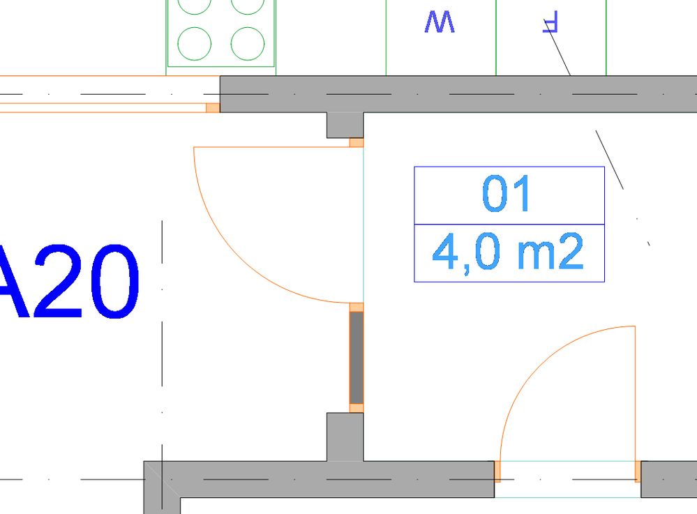

I'm working with AC 11 on PC and have problems with some doors from AC library. I have found that D1 1Sidelight 11 and D1 1Sidelight Transom 11 sidelight window cut fill in the plan is in gray color (see picture). I haven't change any preferences except dimensions. Other doors are OK.

While some window and door objects have no parameter to change this background color, make sure your Pen 19 is white to solve...
I have tried to change all the fill colors, even in GDL script, but it does not effect these objects. And this problem is only with these two doors. When I disable Object's pens in setting window then symbol line pen is used also for cut fills so I get single colored fat line without any details (no frame and glass lines). It seem to be bug in AC 11 library because I hadn't this problem with previous AC versions.

In Door Setting (2D Representation) all the background fills are Empty fill and background color is white and in Floor Plan and Section part it is checked to use Object's Pen. Anyway, if I uncheck that option then frame and glass part background fills with Symbol Line pen color (in my situation is pen color 3).

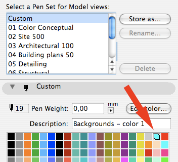

AFAIK INT library does not show up the necessary parameters. Most of the doors and windows I like to use have a hardcoded background color pen 19. It's a solid fill (to be set white..)
Make pen 19 to a different color and you have the problem !

Since you are in Latvia, you probably have the INT library, so your only option may be to set your pen 19 to white as Joeri suggested. And yes, for the record, I think the various libraries that Graphisoft produces should have equal flexibility. The ability to have multiple pen sets in a project should be supported by the supplied libraries.
