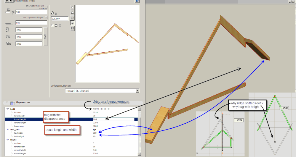

Why in the title used text parameter - it is assumed that I should something to write here?
In the 2d script, apparently primitive Project2. that is not a good solution.
If you attempt to assign chordheight left more valut_start - get the bug with the disappearance of the rack. You must enter (set) constraint in the script parameters - RANGE
Right Parties Left left_tail_width acts on the right side, the same length is likely that command mul applied without axis shift (ADD)
Unnecessary parameters must either lock or hide.
In general it is not even a beta version, and pre_alfa, excuse me.

All of these bugs are now fixed. And technically speaking it would be in an alpha stage. I had only spent a total of like 8 hours at that point so excuse me for there being so many bugs. And I have not yet set restraints as I like to get things working before I start limiting which what and where. And for testing purposes, project2 is incredibly beneficial. At leas for me. And yes once I have the truss to a point that I can create the more complex profiles I will clean up and hide and lock parameters.
Also keep in mind i only started to teach my self gdl starting this last june. so i am still very much so a beginner
and i post my objects for free for people to test. there will always be bugs.
