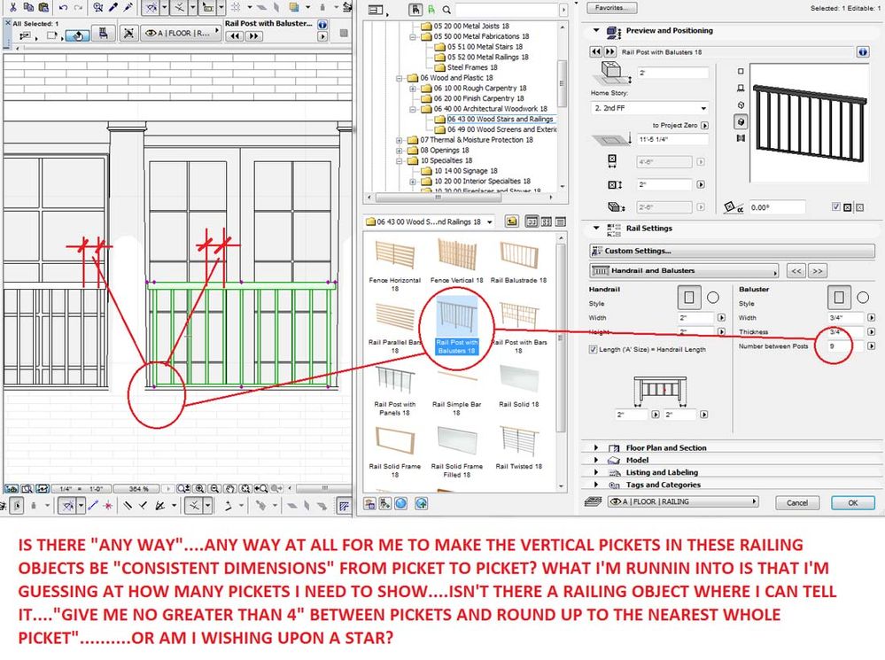

So...is there any railing object that I can use that I can have the "spacing" in between the pickets to be a "consistent" dimension.....say, Ohhh...I dunno, the code says no great than 4" therefore.....can I have a railing with a parameter that can do this?
Right now I'm guessing at 12 pickets, 18 pickets, 24 pickets and only being able to do it visually. Sure...I can take a distance, divide by the number 4 and see what comes up the railings object SHOULD have a parameter that you can set that says "distance between pickets = 4" and be done with it.
And if you stretch the railing....the pickets increase every FOUR INCHES one more gets added.....not this darn guessing game I'm playing right now.

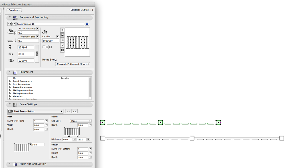

The Fence Vertical 16 object can do it, so it must be possible. Just don't ask me how
In saying that, though, the spacing is shown as minimum, not maximum (or range) and I'm not sure about the spelling of "Plain" tops to the slats.
