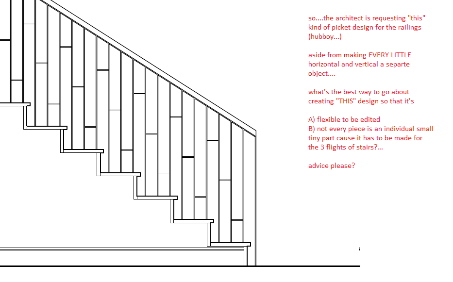

see attached.
besides making EVERY LITTLE bit and piece of this railing a part of objects...how best to accomplish (see red question).

I can't believe I'm going to have to make this "handrail" design as parts and pieces with little pickets and horizontals cause there is no "custom" handrail.
geeez.....

Truss maker is the solution.
Just draw it in 2d (elevation) and transform it with truss maker.
It's easy.

So...I'm familiar with "Truss Maker"
I guess you are then taking the approach to create a "truss" for the stair railing in angle?
Thing is...that then I'd have to determine the exact "midpoints" of the vertical pickets and the horizontal members so that I when I create the "truss" to be used as a "stair railing" it'll offset the proper amount.
So, if my steel picket members are say 1/4" thick, then the linework that is used to create the truss needs to be inboard by 1/8" in order for the truss to expand outward properly?
Yeah...and the non-parametrics on the fly don't help.

Not entirely painless, but you might think about modeling it as a morph. One thing it took me a while to discover is that you can create morphs in elevation and section windows. This is really nice for things like stair railings and ramps. The 2d morph is created in the plane of the cut. Create the flat morph in a temporary section window and then extrude the depth it needs in the 3d window.
