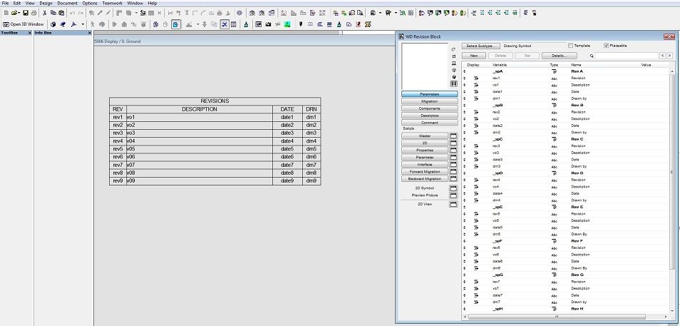

While I am a long time user of ArchiCAD (since version 6.5) I have never really gotten into GDL scripting. So my question may come off as incredibly obvious to regular users of this forum.
Kerdels has recently changed over to ArchiCAD at my urging and as such I am spearheading the set-up of the templates / libraries etc. We have purchased a locally produced library, so any GDL scripting I need to do it minimal to fill in some gaps.
One such gap is the title block. I am using some auto text for most of the title block however I wanted to create an object specifically for tracking revisions. I drew up the grid, etc and saved the selection as an object. I have then added in the variables for revision, description, date and drawn by in the parameters tab. I have also created a simple layout in the interface tab.
So my question ... How do I make the variables actually appear in the object ? In other words I have a blank grid, I have variables in the parameters tab, but it is unclear how I put those variables into the blank grid ?
Your help is greatly appreciated
Attached I have shown the grid and I have shown the parameter variables and where I want them to go in the object

In your 2D script you will need to define a text STYLE.
Then use either the TEXT2 command or the RICHTEXT2 command to place the text.
i.e. TEXT2 0,0, rev1
Where 0,0 are the x & y co-ordinates for the loaction you want the text.
It is not quite as easy as that but this is the basic idea.
When defining the style you need to set the font, fontsize and anchor position (centre, left, top, etc.) and be mindful that it is that anchor point that will be placed at your text co-ordinates.
If you select what you have drawn in plan and save it as an object you will see the scripting required.
You will either need to follow this and add similar commands to your current object or add the parameters to this new object and substitute the quoted text values (i.e. "rev1") for the required parameter (i.e. rev1 - without the quotes).
I think the auto scripted object might use the RICHTEXT2 command which is a little more complex than the TEXT2 command.

I have been able to get the variables to show up as you suggested. As as you anticipated the font, size and justification of the text is way bigger than the original space.
You say I need to define the text style. Is that done through the parameters tab or is it code written directly into the 2D script ?
It is scripted in the 2D script - at the beginning before you place any text.
You will use the DEFINE STYLE command - DEFINE STYLE name font, font_size, anchor, face_code.
