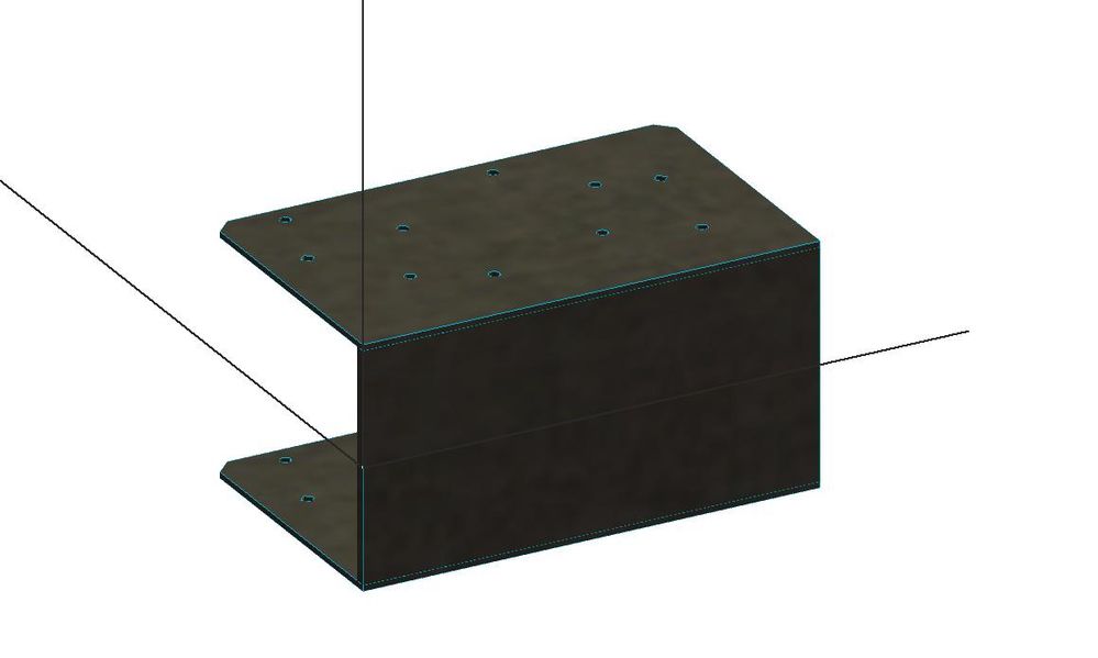

I added a ROT command to the 3D Script and a xrot parameter. I can "invert" Simpson bucket (one object) and straps (another object). The 3D selection hotspots do not rotate. Is there a way to have the hotspots also rotate with the object?

Your image seems to show that you have successfully rotated
the post cap. The hotspots I am seeing may be the default
zzyzx hotspots. I do know that, if coded correctly, 3d hotspots
can be rotated along with the rest of the object but you might
consider using the MULz -1 command if you want to "invert" an object.

Frank Beister
I guess the object uses automatic hotspots or "hotspots of 2D". The objects bottom is now top and the new bottom is in the opposit of the former top. Automatic hotspots are not generated by the model, but AFAIK by A,B and ZZYZX. Your object is now -ZZYZX high. You need to add "manual" hotspot commands or add an ADD-command before or after ROTx. Second is better, because it keeps objects coordinates (elevation/height) in settings correct.

Here is the Code from the 3D Script
! Document name:
! Name : CCQ6b.gsm
! Date : Thursday, May 10, 2007
! Version : 10.00
! Written by ArchiCAD
mulx A/0'-11.0000"
muly B/0'-5.7782"
mulz ZZYZX/0'-6.7960"
addx 0'-11.0000"
addy 0'-2.8875"
rotx xRot
rotz 180
body -1
model solid
resol 36
GLOB_SCRIPT_TYPE = 3
GLOB_CONTEXT = 3
GLOB_SCALE = 48

Hello Jay,
Frank is correct. The hotspots you see are the default X,Y,Z hotspots
generated by the program not by the GDL code for the object.
As Frank says, if you want 3D hotspots to rotate with the
object you will have to script them. One thing that is useful
when scripting 3D hotspots is to use the SPHIRE command
to make small sphires at the same positions as the 3D hotspots
because you can't see 3D hotspot in the library part editing
3D window. After you are sure the hotspots are in the correct
position you can delete or comment out the SPHERE commands.
If you just want to get rid of the hotspots that are floating
above the object you could comment out the line
mulz ZZYZX/0'-6.7960" by putting a few exclamation points
in front of the line like this.
!!!!mulz ZZYZX/0'-6.7960"
Then select the object, go to its settings dialog and make
the "Z" value zero.
This will eliminate the 3D hotspots floating above the object
Peter Devlin
