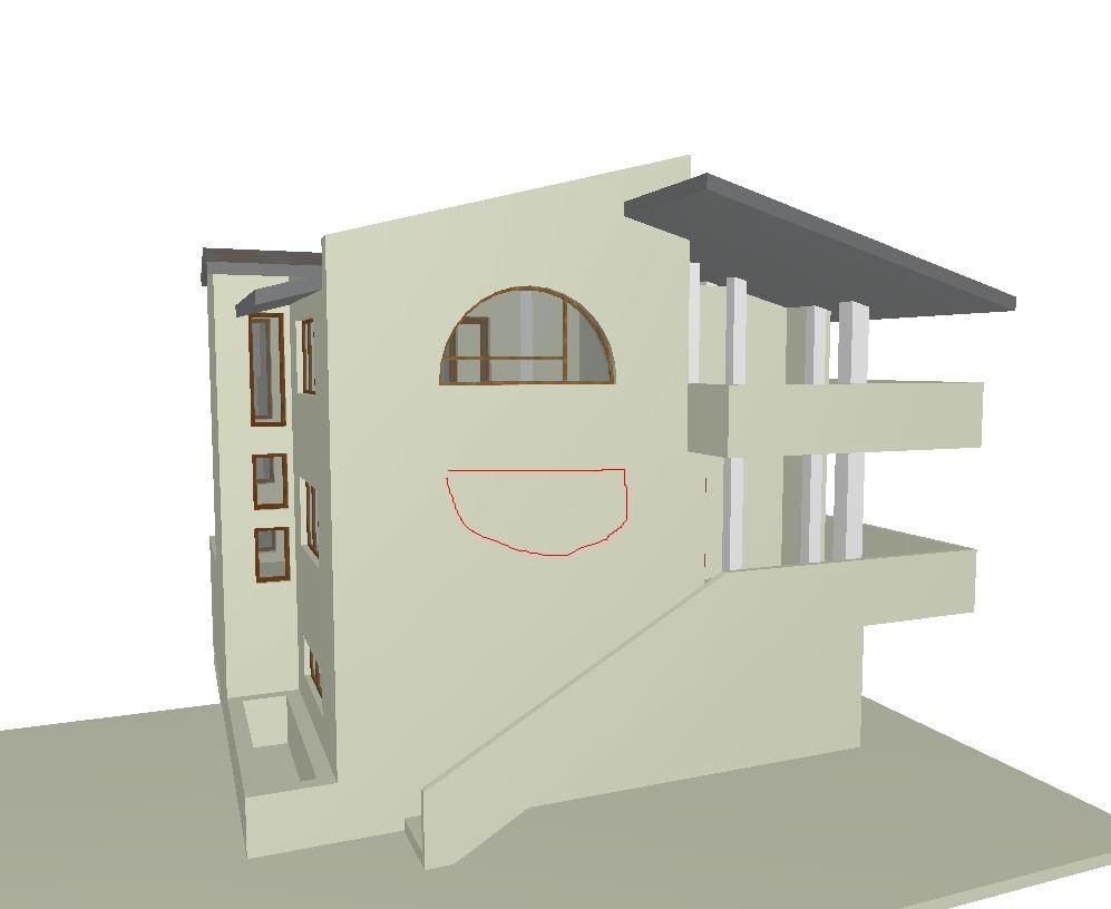

please tell me how to change it in the 3D GDL script to make this window upwards.

As a minimum, you will need to add at the beginning of the 3D Script:
RotX 180 ! to rotate the window around the X axis
AddY -B ! to move the window up its height
AddZ -WALL_THICKNESS ! to move the window back into the wall the wall depth (old school C_)
This assumes no Del Top statements, which would delete these commands so they would need to be repeated after the Del Top. The Script could be more complicated and these commands could need modification, depending on the exact 3D Script, this may call for a bit of trail & error to fix all the code.

Isn't the ROTX 180 also changing the interior/exterior of the Window?
I can't test it right now, but I would try ROTX 180 or -even better- MULY -1

Yes, the MulY -1 will work instead of the RotX 180 transformation, still need the AddY -B transformation, can drop the AddZ -WALL_THICKNESS transformation. All the other caveats apply.
