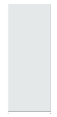

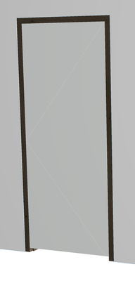

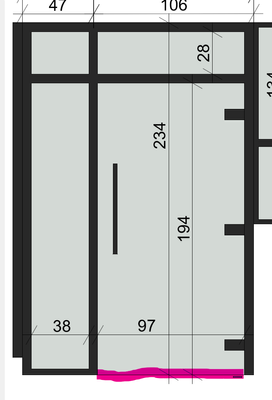

I need 1 cm cut under this customer door leaf, didn't find this option for this door since it is disabled for custom door, making custom door at desired size also doesn't work as it extend to full size.

cuba
Add hotspots 1cm under the doorleaf and save as custom doorpanel

DanyThailand
thanks, works like a charm, still could be added as feature in property.
