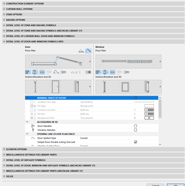

Have you checked here? There are some more options if you scroll down.

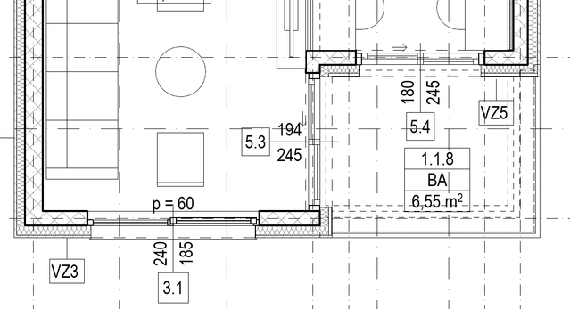

The sliding door (at the bottom left) has the following relevant settings:
I will not paste absolutely all of them but if you need a few more, of course I will. With this object, Multipanel sliding door, which was the part of the Library Update 1, we finally got a useful tool for the type of sliding doors we use in practically every project.

Thank you for the reply.
Yes I have but it does nothing - see pic

Yes, they do. I don't have any sliding windows at the moment.
ArchiCAD 28 | INT - Cro | Forward | WIN 10 / 11
rakurs
This object works nice, and it can even show a half-opened door on plan (or 3D) as expected, if you change the 2D/3D opening length. The arrow moves with the sliding part, too.
(EDIT: I pasted another picture to show another door with a slightly different size next to it, and their respective markers.)
Thank you!
So the international doors have arrows but USA doors dont- I see. That was the problem.
