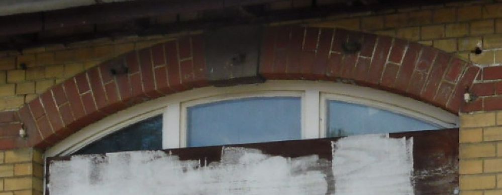

hi guys.
I have these windows all done up below, using a normal element from the library.
the only problem is, the angel and form of the top stones are wong, please see second photo for what i need.
can some one please help me achieve this !
Thank you.
Ian

and this what i really need.
Ian
It depends on which library you are using, but there may be a different part for arch top rather than round top windows. If you can't find the arch you want you can create it as a profiled beam which you can insert at a right angle to the wall.
hi matthew,
i unsertand using the profile editor and making the arch, thats ok.
But how can i make a window go under neath it and the top of the window, follow the shape of the arch ?
Thanks.
Ian

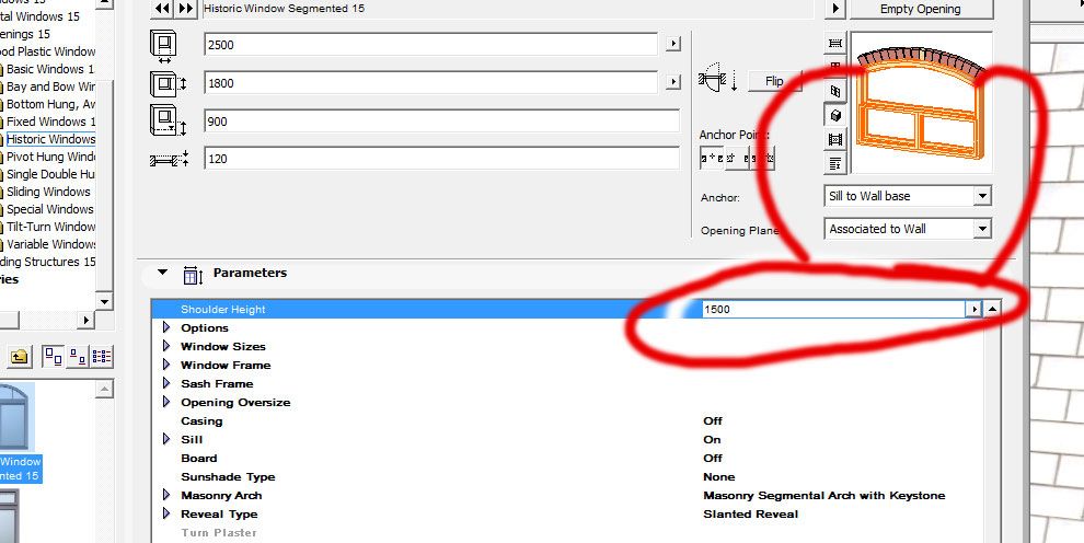

ok i just played around with my english version of archicad 15 at home.
I found this, i think it looks pritty close to the desired photo ?
I hope when im back in the office, they have the same window, fingers crossed.
Ian
and now the controls for shoulder height.
guys, where is the library part called Historic Window Segmented 15 saved.
I would like to drop it onto my usb stick for tomorrow.
Thanks.
Ian
ok the germans have something similiar.
i really nearlly have it.
the only last problem is--- in this window there is one big middle frame, but in the real thing, the window is broken into 3 segments.
any ideas guys ?
Ian
just to remember.
shoulder height in german is the option Bogen.
memo to myself
Ian
