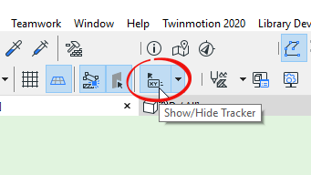

Do you have a tool bar button like this?
I am not sure where/if there is a menu item for it.
TESS
thank you it worked!
