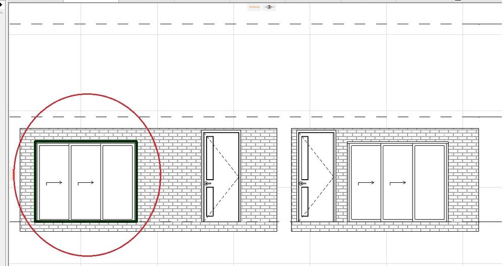

Hey guys i have an issue with my walls not showing my sliding and stacker doors correctly. On the image provided the wall on the left is a custom wall i created and the one one the right is a generic wall from ArchiCAD that came with the program. The doors used are exactly the same in the image.
The issue is that my stacker and sliding doors on my wall show a dark outline for some reason but they don't show it on my swing doors. I want to get rid of the dark outline on my sliding/ stacker doors and i think its got something to do with the wall.

Sometimes a door will use the cut pen of the wall before it is a complex profile or composite. Try changing it back to just a building material wall, adjusting the cut pen to what pen you want your door to be using and then changing the wall back to the composite/complex profile you were using.
This is assuming you couldn't find the proper pen to adjust in the door settings.

Thank you so much that seemed to work!
