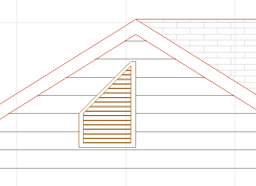

I can't understand why GS does not have a triangular gable vent when it is one of the most common elements in US residential architecture. There are arched ones and i figured out to reduce the curve resolution to 3 or 4, but you and adjust the angle to match the roof.
Why did they not include this?????? Absolutely Rediculous!!!!!!!!!!!!!!!!!!!!!!!!!
Help!

archislave,
You will probably have to build it in the plan using slabs and roofs
and save it as an object or a window.
Peter Devlin
I'd suggest using a triangular window (e.g. W Triangle Fix 10) with some wide (2") horizontal muntins. Shape it in a 3D window.
