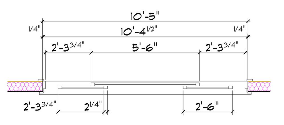

Am trying to set the parameters of this door.
the door is a fleetwood 1000/3000 series bronze anodized frame at 4.5"
depth. The wall that it resides in is a 2 x 6 stud wall = 5.5"
So, the first thing I'm noticing in plan is the frame is not reading properly.
It shows the door frame the same thickness as the stud wall. After going through the dialog box many times have had no success at finding the
setting to fix this. There used to be a "frame same thickness as wall button" or setting...Can't find it. Must be able to have the frame thickness read correctly on the plan!!
Next up is once the frame is shown properly (1" less than the stud wall)
the setting for the reveal to wall face
(outside frame relation to outside face of studs)
is not available. I'v spent like 2 hours on this and can't fix.
The other thing is that the door is reading okay in 3d but the 2d rep
is off. the styles should only be 1 3/4"

like this ? Very easy.
Is this it? I don't see any issues with AC's abilities here... You can even hide the frame entirely if you wish.
Yes, those are the details.
Pay particular attention to the styles width and thickness where they interlock. I have been able to get the door reveal from face of studs and
the frame thickness to read correctly, but not the actual leaf frames.
The jpg below is from a different job with different conditions, but you can see how narrow the leaf frames are. Now look at Marks jpg above.
I have spent hours and have not been able to get the actual panel leaf frames to read correctly. There are settings but they don't translate to the actual plan view. It's crazy and could fit the definition of insanity, trying over and over expecting a different result.
Okay, you might have it. Can you make the center panel 5'-6"
wide and the two operable panels 2'-6" ?

Mark,
It's the stiles that don't seem to be showing correctly!!
I have set them to be 2 1/8" but it shows like 4 or 5 inches wide on the floor plan.
Leaf panel is 1.25" thick with 1" insulated glazing.
Door frame is 4.5" thick set 1.5" back from exterior face of 2 x 6 studs.

Can you show me a XOX sliding glass window with the W sliding3 17 library part that has a 5'-0" wide fixed center panel and 2'-0" wide operable side panels.
Steve Jepson
I can do it. But it takes a little editing of the gdl script than you are probably not interested in doing. Have you tried using the library search engine to find a window you can configure by your self?
Do a search from the Window Selections Settings window for Triple Window and see if that can be configured you need it.
