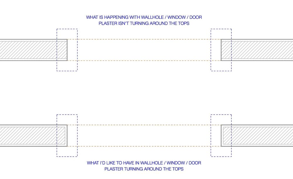

I have a common brick wall plastered on both sides. Whenever I insert a wall hole, window or door i can't make the plaster cover the tops (something like wall ends!). I know there's a turn plaster option but it seems to me it's only related to cavity walls.
I know this probably is something very simple i'm missing but any help would be much appreciated.

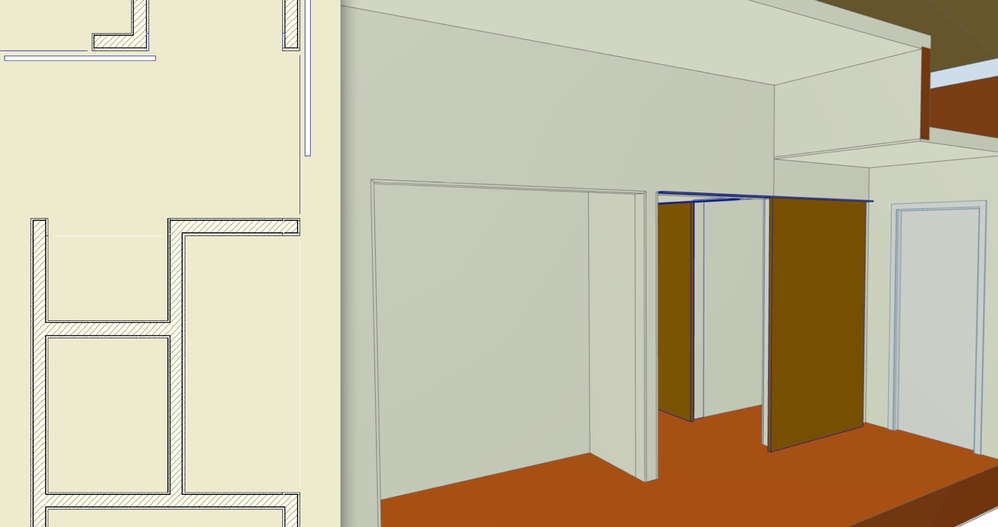

I too just now, after all these years, realized that turning plaster is nothing but a stupid 2D hack, probably because I usually use wood cased openings. Currently there is no good way to model plaster/drywall lined openings or drywall returns. Since there are some of these on every project we do I am really disappointed. We really really need a solution for this!

First of all, turned plasters and wall skins aren't patches or 2D hacks since AC11. Since then they actually cut the wall and extend the wall polygon as needed.
Turning plasters in 3D is a long time wish and it is addressed in AC14. The current 2D functionality will be available in 3D and in S/E.
I'm not sure though that we know the real life situations of US drywall planning. Could you please post a few close-up pictures of the 2D and section drawing of the mounting of such a window?
Thanks!
Zsolt Táskai
ArchiCAD Development - GDL Team
AC13, AC14 and upwards...

Zsolt, I too am heartened to hear that turned skins will get some love next go round. And sorry, maybe "stupid 2D hack" is a little harsh. But anytime something displays in plan that is not there in 3D you have to expect some harsh words.
With regard to US drywall, I don't think there are any mysteries. What we need most is a good way to do drywalled openings, and ceilings, that are correct in all views and work with PSD. Right now my workaround is to use a surface slider with no panel for the opening and slabs for the ceilings. But there are all manner of unwanted lines at the joints, plan and 3D.
