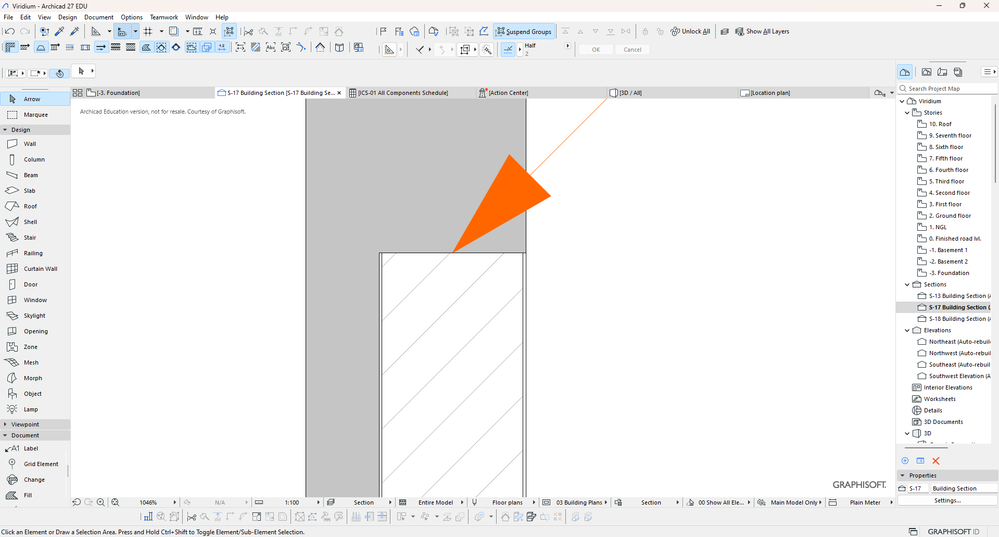

I have a simple composite wall with plaster on both sides and brick in between. However, in section, it doesn't show the plaster at the top. How do I get it to do this?
Before you guys tell me to turn on the wall end in the composites dialog, I already have them on.

Composite walls only have parallel skins.
The plaster will not wrap over the top or around the ends.
You could create a complex profile wall that has plaster on the top.
