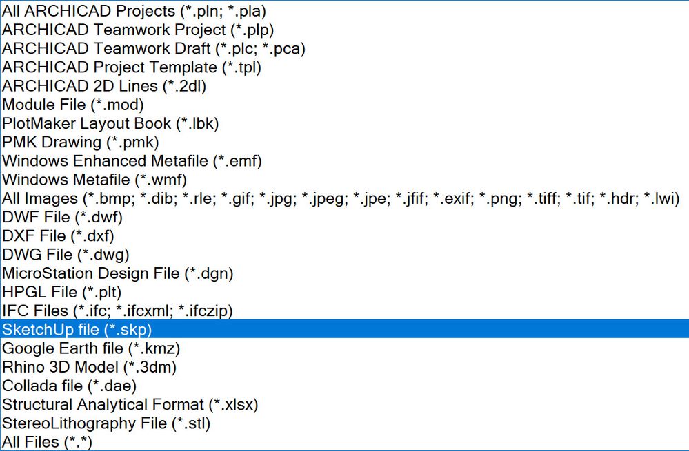

It might depend on what the file formats is of the things you want to have in Archicad
Just copy and paste will work for most 2d things, there are are ways to import some things in 3d. If you can give a specific example of what you want to bring into Archicad I am sure you will get some answers for how to do what you need to do. In the case of importing an image file, Archicad has what is called the Figure Tool you can use for that. or you can just copy and paste image files as well if you want. https://www.youtube.com/watch?v=Gd2QStYNPho
this is a list of file types you can open with Archicad

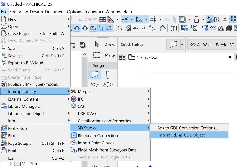

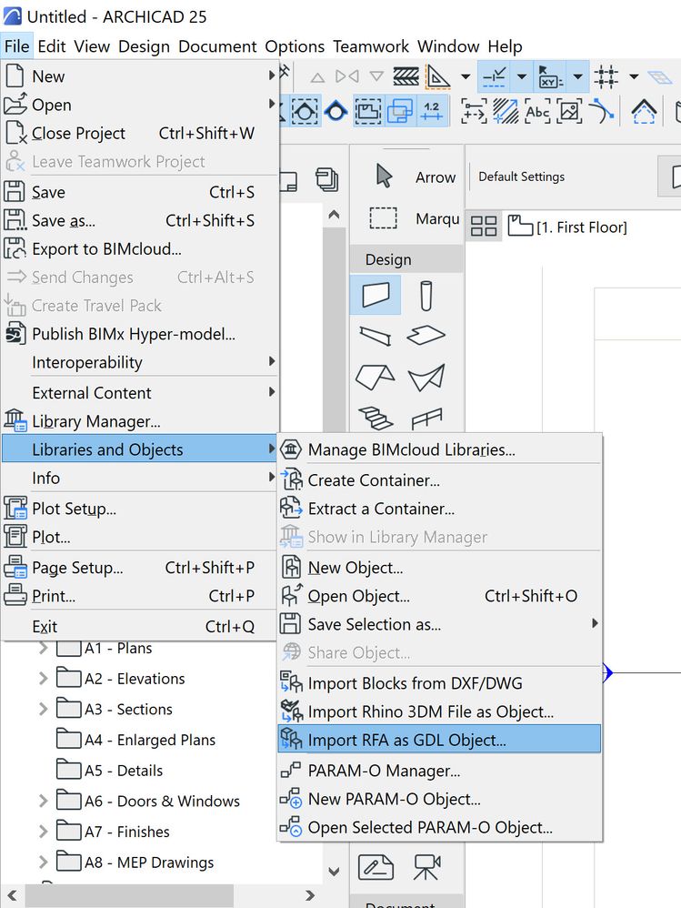

there is an add-on for importing RFA files

Thank you for this I where would I get the add on because my Archicad doesn't show the 3D studio or Import RFA or GDL

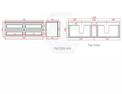

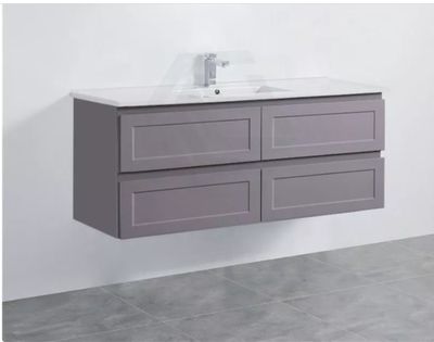

I think I might try to explain myself a bit better
I am using images and line drawing of furniture from a supplier to use in my designs
thank you
see below

‎2021-10-12 08:24 AM
@MLSAussie wrote:
Hi JK88,
Thanks for this... I tried dragging and dropping jpegs but they just stayed as jpegs
I know I am missing something
No you are not missing anything.
A JPG will remain a JPG - it is just an image.
it will not magically convert to a 3D (or even 2D) object if that is what you are expecting.
- Mark as New
- Bookmark
- Subscribe
- Mute
- Subscribe to RSS Feed
- Permalink
‎2021-10-12 09:00 AM
OK.
Images will remain as images and you can show them in your model (plans) just as you have attached them here to your post, but there is not much else you can do with them.
Line drawings can be imported as actual lines if they are DXF or DWG files.
You can then manipulate these lines in Archicad as if you drew them your self.
If the line drawings are an image (i.e. JPG, PNG, etc) then they are just images again - nothing you can do with them except insert them in your plans.
If they are PDFs, it may be possible to explode them into lines you can use, but it depends on the way the PDF was saved.
If it is just a scan or bitmap file saved as a PDF, then you can't explode it - it is just an image.
If it was created in a vectorial program (such as Archicad), then you can explode it into lines that you can use.
None of these will give you any kind of object though, just images or lines that you can use.
So if all you have is JPG files like the ones you attached here, then all you can do is insert them as images.
