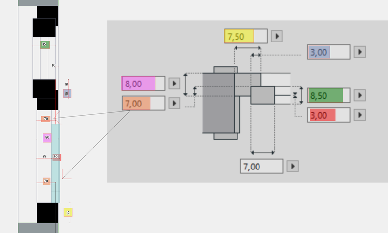

I have encountered a problem with a window's section display. It affects Variable Window as well as Basic Window - probably a reused part of the script. Using options within the window tool, I have configured a window as follows:

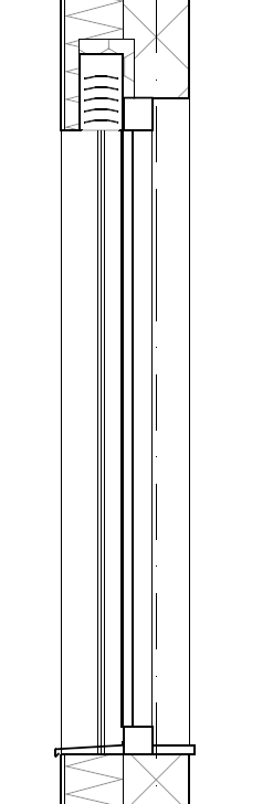

It looks fine in floor plan, but glazing of the fixed part is positioned wrong:

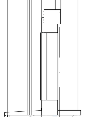

I have pinpointed the problem to the following: instead of centering glazing to the frame, it positions glazing's center to the start of the sash of the main part of the window:

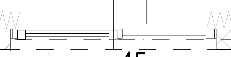

Floor plans (with a variable window with a fixed sidelight) show the correct symbol:
But again, the section is wrong (this is the section through the sidelight):
Basically, the fixed glass part of the window is broken. Pun intended.

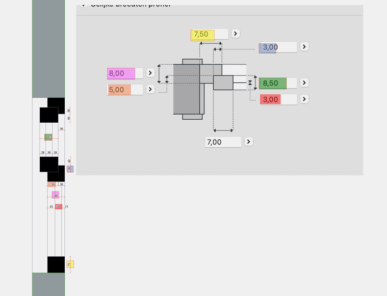

Your glass is 3cm thick, and your opening frame is 8,5cm. The glass will be placed in the middel of the frame.
The glass in your fixed windows is also 3cm.  However you want to place the opening frame only 1cm back (8-7=1). The center of the glass in the fixed frame will be placed at 7cm and is 3cm thick >> the glass will be outside the frame 3/2=1,5.     7+1,5= 8,5cm while the frame is 8cm
Solutions:
A/ make the glass less thick (2cm) red
B/ make the offset of the opening frame less then 7cm (orange value) >> more overlap between windows
Is this a flaw? Yes, but the 3D representation of the window is only symbolic/schematic, so it’s not 100% accurate. They are only intended for 1:50 / 1:100 scales, where this level of detail is sufficient.  It would be more logical if the offset between the exterior face of the glass and the exterior face of the frame were controlled by a parameter, and that this value were consistent everywhere.

The problem is that the symbolic floor plan view is displaying one thing (correctly) and the generated 3D model (and section view generated from it, and projected floor plan view generated from it) is displaying something different. The discrepancy between the two will not go away even if I define the windows differently. These are the (rough, not up to fractions of milimeters) specified dimensions of the frames given to us by the window maker. I want to show the windows as close as possible to the specifications because we are trying to very deliberately position the openings, and have them aligned to different elements on the façade. If we start to imprecisely define the things that are objectively defined by specifications, it might produce problems when actually things are going to be built.

Archicad uses two separate scripts for windows and doors: a 3D script for the 3D model and elevations, and a 2D script for the floor plan.
This can result in differences between the 2D floor plan representation and the 3D model representation.
Alternatively, you can use the 3D script to generate the floor plan as well, by setting the Floor Plan Display to “Projected”.
