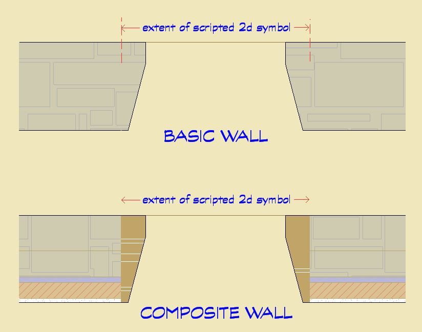

I'm working on a door object with slanted side reveals. This has to be specially scripted because it also features a canted arch at the head. The 3d script inserts a MASS into a WALLHOLE and seems to be behaving itself, but the 2d symbol script for the added wall bits has me stuck.
In a good old "basic" wall with one material I can add fills for the side wall bits that match the wall fill using the global variables:
fill WALL_FILL
poly2_b{5} 6, 2, 0, 3, WALL_FILL_PEN, WALL_FBGD_PEN,
0, 0, 1, 0, 0, 1, 0,
A/2, 0.00, 1,
A/2, -frd, 1,
(A/2)+spl, -WALL_THICKNESS, 1,
(A/2)+spl+0.04, -WALL_THICKNESS, 1,
(A/2)+spl+0.04, 0.00, 1,
A/2, 0.00, 1
But in a composite wall with skins, the WALL_FILL_PEN and WALL_FBGD_PEN global variables no longer work. It looks like WALL_FILL will match the fill pattern of the first exterior skin, which I could live with. But I have no idea how to match the fill pen and background color of that first skin (or where the colors that do display are coming from) I can always hardwire the pen colors to match the skin, but it would be nice if the script did that for me.

what you need is in wall parameters:
wall_skins-number
wall_skin_params
The fist is the number of the skins, the second is an array in which you will find parameters for each of the skins, if i remember [1] is the fill, [4] is tha fill pen and [5] is the bkground pen.
You can search the reference guide for the correct syntax.
Hope it helps

WALL_SKINS_PARAMS parameters of the composite or complex wall skins
array with 17 columns: [1] fill, [2] thickness, [3] (old contour pen), [4] pen of fill, [5] pen of fill background, [6] core status, [7] upper line pen, [8] upper line type, [9] lower
line pen, [10] lower line type, [11] end face pen, [12] fill orientation, [13] skin type, [14] end face line type, [15] finish skin status, [16] oriented fill status and with arbitrary
number of rows, [17] trapezoid/double slanted status.
So you are looking for value 1 for the fill type , value 4 for the fill pen and value 5 for the background pen.

David Collins
Ilder & Barry,
Seems like ArchiCAD 17 pretty much blew a self-taught GDL cookbooker like me out of the water!
Many thanks for the beyond-the-call-of-duty WALL_SKINS_PARAMS tutorial. The array variable solution is really elegant (my way of saying I haven't a clue of how that works, but nevermind...) I should be able to get it to fly now.
I now find I have a similar problem when the door object is cut in 3d:
In a simple (basic) wall, WALL_MAT_EDGE will match the cut surface of the MASS to that of the wall. But this doesn't work for Composite walls. I suspect it's the same issue: How can I reference the material surface of a wall skin?
The WALL_MAT_EDGE does match the wall edge but now in 17 & 18 you might be displaying the Building Materials for each skin rather than using the wall edge override - so they may not match visually.
The problem is that GDL objects cannot use Building Materials so they still need to use WALL_MAT_EDGE or WALL_MAT_A or WALL_MAT_B
You can however find the Building Material for each skin – you just can’t use it.
For the Building Material of the skins you need WALL_SKINS_BMAT_NAMES
For the first skin you want WALL_SKINS_BMAT_NAMES [1]
The number in square brackets just represents the number of the skin you want the Building Material for.
I can’t see any way of finding out the surface (material) associated with a Building Material – which is what is needed here.
Maybe someone else has an idea?
I am not sure why I fed the values of the WALL_SKINS_PARAMS into an array before.
This was all scripted many years ago and seems to be working so I just left it as it is.
I tried to do the same with the WALL_SKINS_BMAT_NAMES but couldn't because it is a text output and not numeric like WALL_SKINS_PARAMS.
So I realised it is already an array itself and you can just choose the bits you want by adding the correct values in square brackets afterwards.
So for your splayed reveal you just need ...
fill WALL_SKINS_PARAMS [1][1]
poly2_b{5} 6, 2, 0, 3, WALL_SKINS_PARAMS [1][4], WALL_SKINS_PARAMS [1][5],
A/2, 0.00, 1,
A/2, -frd, 1,
A/2, 0.00, 1
No need at all for the code I posted before.
I seem to like doing things the hard way.
David Collins
I discovered this purely by accident (deleted the array loop by mistake) but from there I realized I could insert an integer parameter for the skin number :
WALL_SKINS_PARAMS [skinmatch][5]
Which lets me select which skin to match: useful since this object will be used in several different composite walls.
In the spirit of Keeping It Simple, Stupid, I just added a material parameter for the MASS side, which gave me control of the 3d cut display. Good to go!
