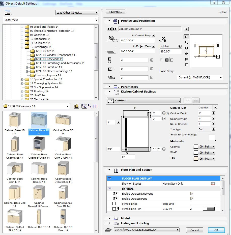

OK I'll bite. New to Archicad.
Where are the cabinets so I can draw my Kitchen?
Did a search, nothing. Looked in CSI libraries, nothing.

Object tool (chair icon). Become familiar with the "Find' function as shown in the attached as you get used to where things are located in the libraries.

Gerald Hoffman
Taoist,
You should add the version of Archicad that you are working on into your signature as the answer to questions can be different. In version 14, Cabinets are located in the Furnishings directory. See attached.

Check also the Depository for an object called "CabinetONE"
http://archicad-talk.graphisoft.com/object_depository.php?
Depository> 12 Furnishings >Cabinets Shelves
