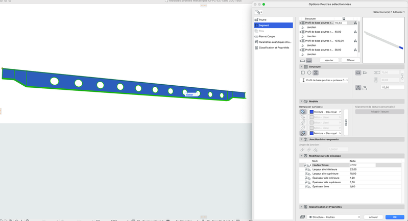

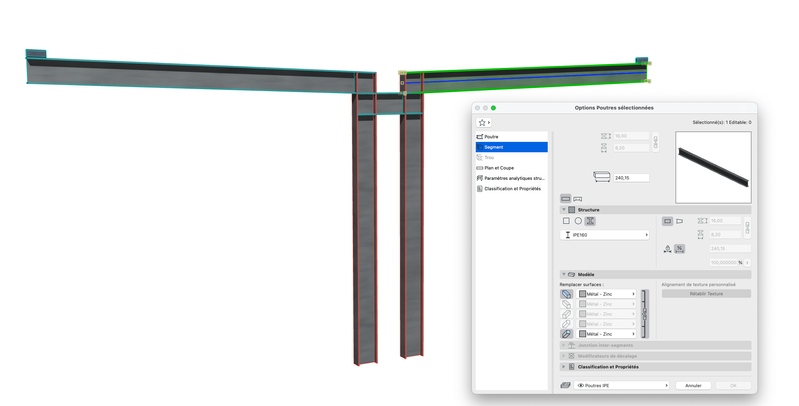

As long as I remember, when the complex profile were introduced the database was there.
The other benefit of using the beam and column tools with those profile is that you can take advantage of the automatic intersections between elements and follow the evolution of those tools to easily create more complex elements from standard profiles assembly.

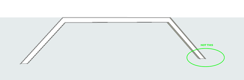

And unless I'm missing something else, these complex profiles act too much like beams.  I can't get what I could with the old W Beam Object without more work.  And the Object Settings allowed me to edit the beam ends independently.  See screenshots.
AC 6.5-29; macOS Tahoe; 2021 MacBook Pro M4 Max

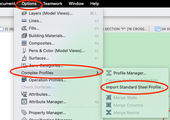

The complex profiles are under the Options pulldown.  See my screenshot attached.  You have to "load" each size beam you need for the project, but at least they're in Imperial sizes, not metric. But these act like beams.  And it turns out I don't like them as much as the old W Beam Object.
The old W Beam object can only be loaded if you load the Archicad 28 Library.  It's NOT in the "libpacks".  So load the Archicad 28 library and with the Object Selection Settings dialog window opens, search for "W Beam" and the object "W Beams 27" should be in the results.  This is the object I have used in the past.
So if you're like me, and trying to stay up to speed on what appears to be Graphisoft's new library organizational method using the "libpacks" we don't get the W Beam object.  We're hosed.

Exactly! This is part of my problem with using the column/beam tools to make actual columns and beams.
1. We need to be able to control the end conditions (as you've shown), and
2. I rarely want structural elements to magically heal to each other.
The beam tool is great for beam-like profiled elements (like metal trim, copings, and fascias; precast wall caps; etc.) where I want clean corners and intersections, but objects make more sense for actual beams.
