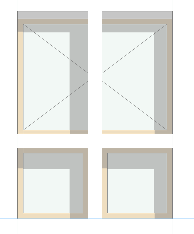

I need to create a window with a total of 4 panels, two above and two below, with the ones on top openable and the ones below fixed.
I am attaching a drawing of what I want to achieve. I need it to be a single object because I need to generate schedules to be provided to the window maker for a quote.
Is it possible with the Archicad default tools or do I need to buy Cadimage plugin?

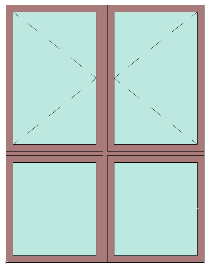

In Dutch library I can set this up with double window and define a bottom or top part to be added. All the glazing/windows can be set up individually after that.

I was wrong, with this solution I get the two openable panels resting onto each other when closed, while I need to have a piece of vertical frame between the two openings for them to rest on in order to cover a piece of wall.
Basically I need to be able to widen the top panels as I did the bottom ones in the attached figure.
