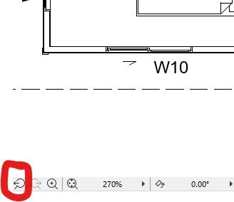

I have run into this issue myself, though I don't have any imported objects and I was not touching the stairs at all when the issue occurred.
It feels like it's come completely out of nowhere. My model was fine, then it wasn't.
My workaround is to hit the undo button next to the zoom settings at the bottom left of the screen a few times until it fixes, then I can work normally, but as soon as I zoom extents the problem reappears.
It only seems to affect some layer combinations, though I can't pinpoint why. Also some views can be reset by swapping between views, but others are persistently affected.
Thank you.
Archie06
I found another thread describing the same issue, their solution of sytematically checking layers one by one to isolate corrupt objects helped me resolve this. In my case it was a (single) wall covering. Once I deleted the problem covering and replaced with a new one, the issue appears resolved.
See the thread below for detailed instructions.
https://community.graphisoft.com/t5/Documentation/I-can-t-zoom-into-my-section/m-p/238905/highlight/...
