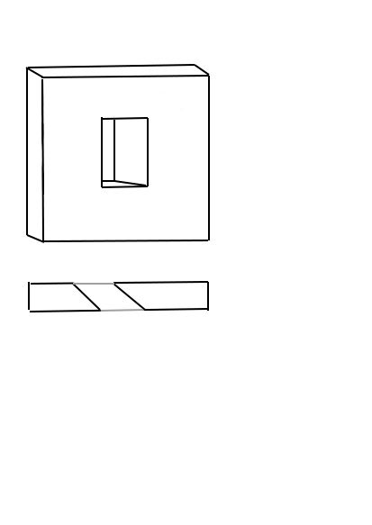

Hi, I want to put an angled window in Z axis like the one in the image. Thanks

Hi Darsus, Will you give us a little more details. Is the wall where the windows is angled in Z?
Hi, yes the window must be in a wall. I want something like I have put in the new image, so the window doesn't have the same angle than the wall.

Hello, I'm not sure if a regular window can do that, but you can do it with a custom window. If you don't know how to make a custom window, type custom Windows in the knowledge Center, and you'll find explanations how to do it

Darsus:
One solution is to use Solid Element Operations (SEO). Create a Slab that will cut the desired hole in the Wall, use SEO to make the cut (Subtraction), then place that Slab on a hidden layer. Then place a small Wall inside the cut hole to host a Window. The SEO will not show in 2D, so Lines and Fills will have to be added to the Plan.

You can always try a polygonal wall.
Place and empty opening or window and then you can rotate it.
