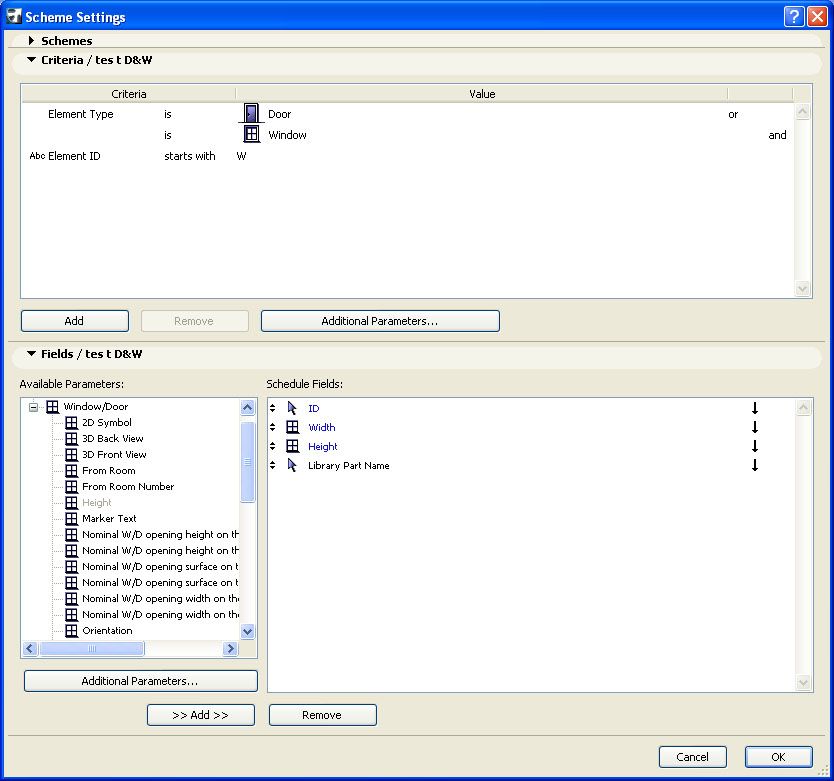

yeah i was thinking of doing that but then it would mess my schedules up with that window being in the door shedule instead of the window one?? or am i able to get it to work ???
Erika Epstein
Set up your schedule to include doors and windows and then in the ID field to start with W (or whatever you use).

Erika Epstein
and

nice didnt think of that..
things are to easy to be obvious in AC..
Cheers
gene
vfrontiers
You could also open the BIFOLD door in the GDL Editor save as a WINDOW by resetting the subtype.
Might be some mess to clean up in the parameter box, tho.
