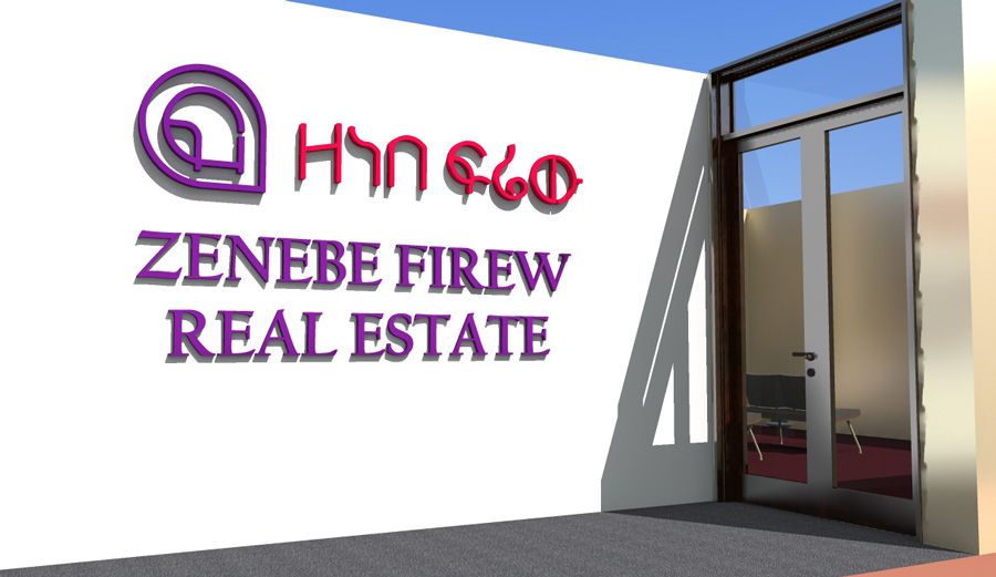

I would like to create a custom graphics logo plus local text on a wall in a new floor entrance. I can create the graphics logo on floor plan, but unable to fit on the wall (rotate it along z axis) that the logo is supposed to hung or attache.
any help appreciated.

This is the entrance of a real estate office floor. where I want the logo to be displayed in 3d.
English text is done. thanks everyone.
the remaining is creat logo & font in Amharic (local text) to be displayed .
logo & local text in Amharic
/ geez font.

You have two options:
1. Make the logo and whatever else you want from slabs, save it as an object and then rotate it along the x axis before placing it.
Read: Creating Custom Objects
2. Make the same thing as a complex profile beam or wall as suggested by Erwin and place it at the correct location.
Read: Complex Profiles

DONE.
Thanks everyone.
specially to = v i s t a s p =.
The last help is simple & helpful.
