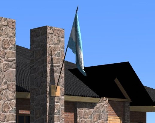

I made something a couple of years ago that looked enough like a flag hanging on a vertical mast with no wind. I just used the mesh tool in plan and then made a library part out of it... You could do the same thing...
Thank you guys for answer. I could insert a hanging flag with this tilted mast in my work using the add-on "3D studio in".
I modified an existing group of 3 flags leaving just one in 3ds max and saving like *.3ds file and then I imported and converted to GDL object in ArchiCAD 10 using this add-on. [/img]
The holy add-on:
www.graphisoft.com/support/archicad/downloads/goodies10/INT.html
