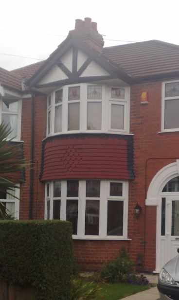

Is there a window that can follow the shape of a curved wall or would somethng like the curtain wall tool be required here???

You have it in the standard Windows library:

j12ebr:
Or create a curved wall and place individual window units in the wall. The window units in your photo appear to be straight, not curved.
