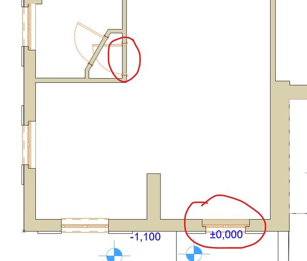

AC28 Suddenly some windows and doors act like there is no opening

Very likely that you have one of your renovation filters turned on. Happens with me from time to time but have yet to find out why.

What @rjwilden suggests. It can also be:
-duplicated elements
-similar objects from other floor that are shown in this floor level for many reasons
-duplicated elements that were put on a hidden layer, but that it is ON on this particular floor plan.

Thank you.  tahts what happened to me too, still i dont know why. Also the renovation filter switched to show all the status.
