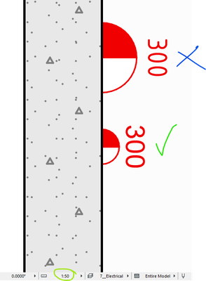

Hi, Is there anyway I can make electrical outlet 2D symbol to adjust the size to match drawing scale?  I set up 3/4" scale drawings, everything changed accordingly  except those MEP symbol. like outlet, switch. it seems like they set up at 1/4" scale and never changed.

MUL2 GLOB_SCALE, GLOB_SCALE
Put that at the beginning of the 2D script. This will make something placed in a View scale against the drawing scale so that it is always to same size. If the object generates it's 2D via a Project2, you would need to use a GLOB_CONTEXT to limit the scaling to 2D only and add a z to the transformation.

That worked perfectly for scaling the object!
Next question - how do I stop the text from scaling?

I am not quite sure what you are trying to achieve... I am assuming this object was created by saving from the floor plan? You can Define Style then use a Set Style. Your text would then be defined as AC_TextSize / GLOB_SCALE, but by doing this, going from 1:100 to 1:50, your symbol would double in size but the text would not... and the relevant position change would need to be made.

But simply in the 2D script before you draw the object ...
if scale_sens then
    MUL2 GLOB_SCALE/100,GLOB_SCALE/100
endif

Basically, I wanted the 2D object to show smaller at 1:50 or 1:20 but the text to remain at 1.5 size for all scales.
Using GLOB_SCALE in the Define Style line as you suggested worked perfectly. I had to use *100/GLOB_SCALE as I had drawn the original object at 1:100 before I learned that it's better to draw them 1:1.
I attached the screenshots of the old and new objects for reference.
Thanks again for your help!
