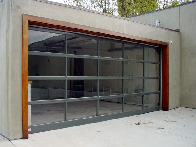

I have been fiddling with the garage doors in r11 and cannot figure out how to achieve a door as in the attached photo. Simple frame with glass panels. Searched in the forum and was unsuccessful. Have learned that the doors have some quirks that I have not been able to figure out. Eg the grill position throughout seems to be ineffective. Anybody been able to decipher?

Tinkering this evening and figured out a work around.
Using garage door 2 and then selecting door style 5, I set the "rail height" to 2" and from there manipulate the horizintal and vertical grid number to my preferences. This way I can manipulate the glass setting to simulate frosted or translucent if desired. Not perfect but works great for now.
