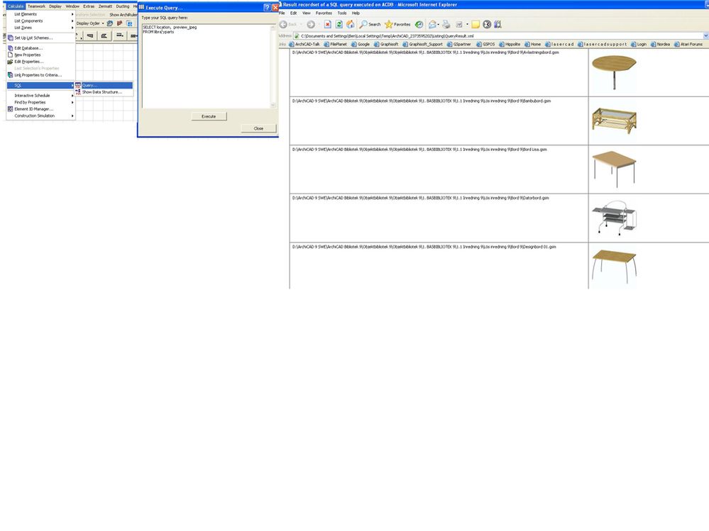

Whilst Woody's method seem much more through, you could run a quick SQL query.
What you will need to do is, load all of your librarys then go to your calculate menu---->SQL---->Query.
Once you have your query window up simply type in the following
SELECT location, preview_jpeg
FROM libraryparts
The result from this query will give you the exact path and an image of your library part, the image part of the query will not show up if the object has no preview image.
HTH.
Cheers.
Ben
FROM libraryparts
HTH.
Cheers.
Ben
I wonder if it would be any better to modify this a bit like below:
SELECT name, location, preview_jpeg
FROM libraryparts
This way the first column would list the file names, which would allow one to see the duplicates, as these would be listed next to each other.
