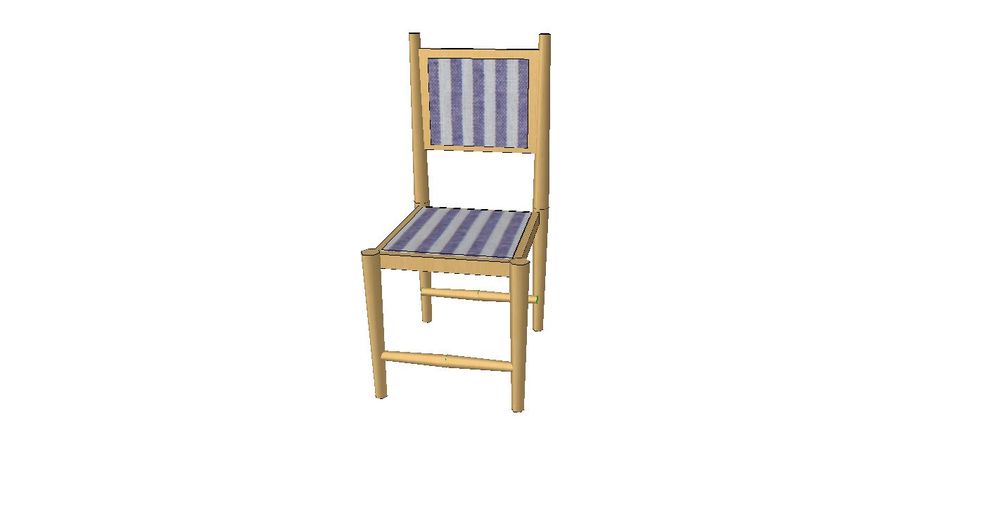

parametric chair difficulties
Following the 'Intro to object making" guide I have reached to a point with my gdl object where I can't understand the mistake I made, which causes a error message concerning line 31, at the master script check.
I need some help here.All I did was to follow,step-by-step,the exact instructions of the guide.
here is the master script

10 REPLIES 10
Seems to work OK for me. Have you added "chairtype" to the list of parameters? I only get an error if this parameter doesn't exist.
I also noticed you have mis-spelled chairtyp =cv7 in the Masterscript. Should be chairtype =cv7.
Hope that sorts it!
thank you for your time,however the problem was the double braces i did't use around "chairtype". it should be
if "chairtype"<>cv0...
if "chairtype"=cv1...
..and so on..
now the problem is that the 3d view of my object does not react to any change of the value of "chairtype"...
i am wondering,does some part of the script need to be written inside the 3d script and some other part inside the master script? is that my mistake?
deinan,
where you have part of the script like this
IF chairtype =cv1 THEN !Footstool
stlgth=0.35: stwidth=0.30: stheight=0.28:
lsec=0.04: backsec=0.04: arms=0
bakon=0: bracetype=bv0
ENDIF
are all these parameters? if so you will need to change the script to read like this
parameters stlgth=0.35, stwidth=0.30, stheight=0.28,
lsec=0.04, backsec=0.04, arms=0,
bakon=0, bracetype=bv0
ENDIF
This applies to every other parameter you are trying to change its value in the Parameter or Master Script tabs. If it is a variable however, it does not need to use the parameter command.
Hope that helps...
some of them are variables while some others are parametres.I corrected the script where parameters were involved.still it doesn't work, plus there is an error message,saying that i am using non-necessary symbols at certain places.i couldn't find any of those symbols.
here is an example
IF "chairtype" =cv1 THEN !Footstool
PARAMETERS arms=0, bakon=0, bracetype=bv0
ENDIF
the error message indicates the second line
any ideas?
Where you dont use the PARAMETERS command you can use your original script. So replace your , with : as below.
ENDIF
It may be a personal preference but i would actually write the script like this, much easier to read once you have to find it and read it quickly amoungst hundreds of lines of script.
!Footstool
if "chairtype" =cv1 then
stlgth=0.35
stwidth=0.30
stheight=0.28
lsec=0.04
backsec=0.04
parameters arms=0,
bakon=0,
bracetype=bv0
endif
Thank you,i corrected the symbols,there is no error message now.Still my model doesn't respond though.. I am sending again the current scripts and an image of my variables and parametres,maybe you can help me find the mistake i am making as a newbie..
3d script
