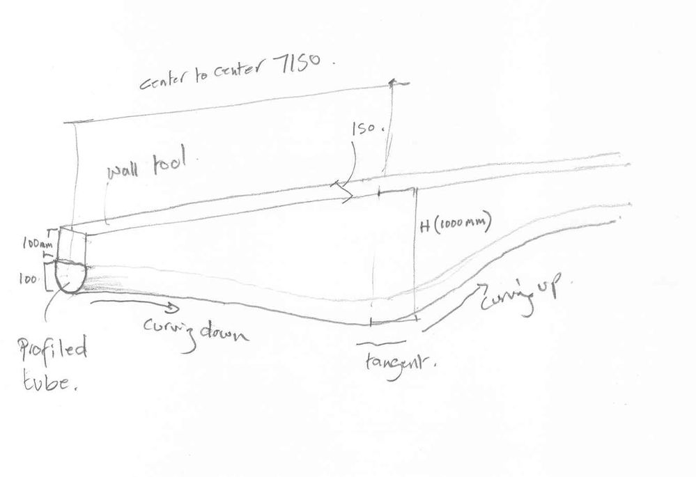

I'm trying to do the lower part of the curved wall (attached) its an extra piece were Profiler may be used, but when it comes to bending it to follow the lower curved edge of the wall, its not easy, any advice?
Do you mean like this?
woodster
Exactly...
How is it done? + its a semi circle pointing down.
thanks
saif wrote:
Exactly...
1.
In the Plan View create the Profile (A.). I used 1/2 a circle, a line to close the shape and Grouped them.
Draw 1/2 the Path (B.) using the polyline tool, mirror a copy (assures symmetry), select both halves and choose Tools/ Unify
With the Profile selected choose Tools/Profiler, I set the Profile Anchor Point (A.) and Space Bar clicked on the end node of the Path (B.)
