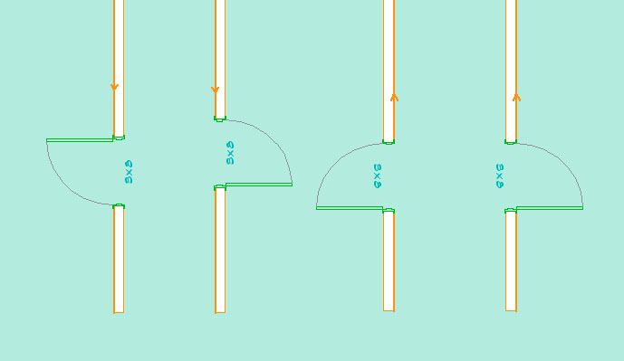

Do I have to alter GDL script? to rotate the attached markers?
Funny thing... a couple of doors on a lower level have markers with correct orientation. When I "eye dropper 'em" and place them on this level, the markers flip.

I do not have the marker objects, because I am using INT and HUN (garian) versions, but you should be able to do it. Probably either an ADD x,y command in the 2D Script should do it.
You need to find the linein the 2D Script that creates the width/height text.
It will probably be a TEXT2 command.
Then you need to insert an ADD command before it, then a DEL command after it.
The ADD command will move the location where the TEXT command generates the text, the DEL command undoes the ADD command so you get back to where you were before the ADD command.
Something like this:
ADD 0, y
Text command generating width/height
DEL 1
The y value will probably be a negative number.

It seems door markers care which direction walls are created when deciding which way to orient the "Builder Dimension".
Cool for us who are GDL-script-phobics.
