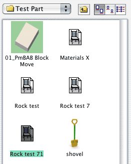

hi there! I've been using some gdl objects that I collected from the web and imported them into my projects using archicad10. now I switched to archicad11 and now when I'm clickinh through my own library with the collected gsm files... I can only see the file's name, but not a preview anymore. this never happened with archicad10 before and the files are exactly the same. does anybody have an idea how I can change some settings in order to preview what I am importing into my project?

thanks for trying that out: still... I do get the previews in that field... but I do have to import the file into AC before I can see it there (see pic1)... but when I just go via the normal object import route (see pic2)... I don't get a preview when I search for an object that I want to import... this has always been the case before.
so if you didn't import the gsm file into AC, but have only put it into a folder and linked it to AC like the original library folder... it would be great if you could let me know how you did this. this would definitely be another option.

I don't know German, so I am guessing that this is the Open Object dialog. I am getting the preview whether or not the object is in one of the loaded libraries. Your signature and screen shot indicate you are using OS X.5 (I am on OS X.4), so that might be the difference, or perhaps something else.

hi david,
yes.. I guess that is the problem... leopard is great ;o) but this is really disturbing ;o(
thanks a lot for trying though!!
if you should get leopard at some point and find a way to work around this... let me know ;o)
