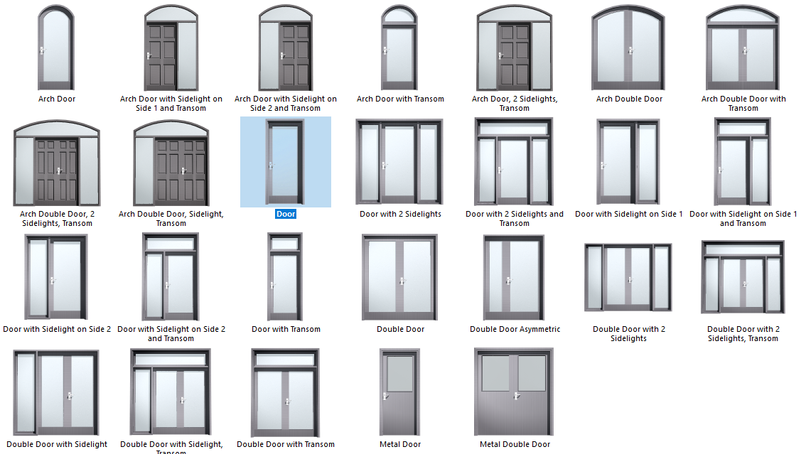

Also, the trouble with doors and windows is that they're flexible and sometimes not flexible enough, but you cannot know until you stub your toe into a rigid edge of an object.
I like to create windows with the same principles (frame width, depth, general geometry, materials, pens) and if an object just barely cannot do what I need, then I have to redo all the little things again. That's why I mostly use Variable Window, but even that object has limitations and there's Variable Double Window... There should be a "master" door and "master" window object which would replace most of the objects in the same folder.
I feel like almost all of these could be replaced with a "Variable Door" type object. I really hate having to redo all the settings when I realize I have to change the door type. And no, I really despise that functionality to be turned over to "favorites" because that's honestly just a crutch and a workaround.
Transom? Yes / No
Left sidelight? Yes / No
Right sidelight? Yes / No
Arch: Frame? Transom? Door Leaf?
That's just awful that we have so many different specialized objects. It should be favorites who should be specialized, in my opinion. Not the objects themselves.

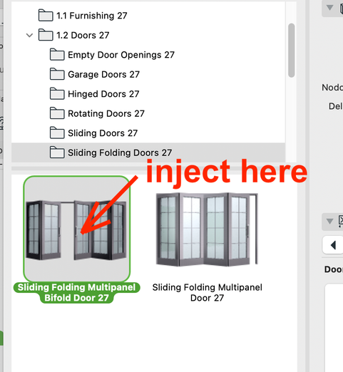

 [Independent of the whole discussion, just in case:] The settings shared between both door types will transfer if you pick up parameters (syringe extract) from the door instance you like and then inject them (syringe inject) on the new door type in the object settings library view before placing it.
inject parameters to different door typeinject parameters to different door type
