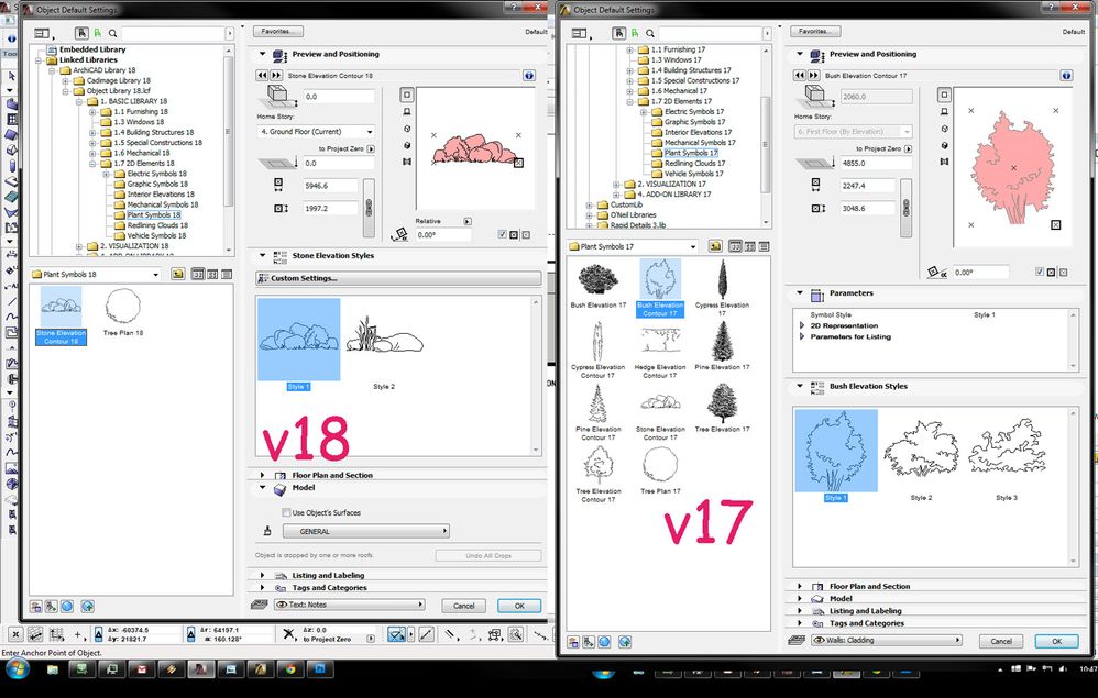

Dear Graphisoft
Is it common practice to reduce libraries and functionality between 'upgrades'
the 2d plants i usually use are no longer available (see screenshot) so instead i have had to do a 'workaround' a word that has become all to common place in our office while using archicad lately unfortunately
I have had to open a v17 file and explode the 2d elements into primitive forms so that I can copy and paste them into a v18 file
losing the functionality of a gdl object along the way however
(by the way; why is it that we can only explode elements in the plan view??
why can we not do it in elevation or section view? you cant tell me it has to do with it being a 3d element because 3d elements are in all viewports and im talking about exploding a 2d element)

I just checked the 18 library and it does appear they are completely missing and have not been replaced by any other object.
They aren't in 19 either.
Don't know why because there seems to be nothing similar.
An easier way to get them back in your plan is to search for them in BIM Components from your object settings dialogue.
James B
Regarding the Plant symbols, if you go to:
2. VISUALIZATION > 2.2 Site Improvements 18 > Garden
You will find many symbols here, where you can choose from top view, side view and symbolic versions of both. The individual symbol parts were just merged into these with expanded options.
See here: https://youtu.be/8rtyn3IZhxk

I should have checked properly first before posting.
My suspicion that they were merged into a new object were right as confirmed by James.
But there is no need to load a migration library.
I placed a 17 object - 'Bush elevation contour 17' - from the 17 library.
Unloaded that library and loaded the 18 library and it automatically switched to -'Shrubs 18' - with exactly the same settings.
So no need for the migration library as the migration side of things is already scripted into the object.
So the plant objects are only missing if you are looking for them as their original file names.
They are now merged into the new plant objects as James mentioned.
It may take a little searching to find the profile you want if you are placing a new object but if you have used them in a file with the 17 library and then switch to the 18 library they should convert automatically.
