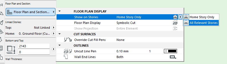

the thing I don't understand about this is that if the wall is set to "symbolic," it has to be set to "home story only" ("symbolic" can't be accessed otherwise), however, the wall won't appear the second floor if stretches from the ground to the roof (past two or more floors).  Is the fix to just model walls per floor? or am i missing something?

Symbolic walls can be 'Home Storey' or 'All Relevant Storeys'.
I am having the same issue, following all replies above. In response to Barry Kelly's last screenshot, I see the same options as he is displaying, but once I select "All Relevant Stories", the Floor Plan Display automatically changes to "Projected with Overhead". Is there a way around this?
No.
As soon as you choose 'All Relevant Storeys' the wall will use the Floor Plan Cutting Plane, so 'Symbolic' is no longer an option.
"Symbolic' ignores the FPCP and just shows you the wall as it was set up in the composite, regardless of it's height or position.

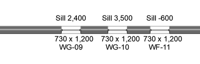

As long as the window falls within the storey being viewed, the window will show. Or are we talking about not even cutting the walls in question? Such as when you have a multiple buildings on a sloped site? There is are seperate threads regarding that. The short answer to that is to either stitch multiple views with different FPCPs or to only use single storey symbolic walls.

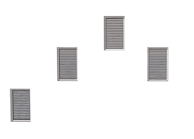

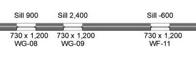

If you are not working with staggered floor levels across a sloping site, there should be no need to model the walls by storey. As shown in my image above, windows 1 to 3 are linked to storey 1 but only windows 1 and 2 show on storey 1. Window 1 being within the cut plane, window 2 being above but still within the storey and window 3 being outside of the storey. Window 4 also shows on storey 1 even though it is linked to storey 2 and is above the cut plane, since it overlaps with storey 1.
