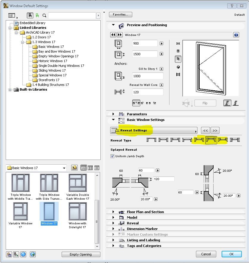

I am doing a measured drawing and some doorways have splayed jambs. The splay varies on each side of the door from about 45 degrees on one side and 15 degrees on the other. What is the easiest way to create these?

Depending o n the Window object you're using you will have different reveal options. If you're using the default library, you should see something like this: ( see attached image)

Thank you - you saw the light even from the dark side!
I am a Cadimage window user and it hadn't occurred to me to look at Archicad's own window settings.
